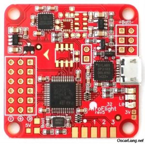

![Controladora Naze 32 F1](https://dronemodelismo.com.br/wp-content/uploads/2018/02/naze32-300x298.jpg)
Entre as controladoras conhecidas que utilizam processadores F1 estão as Naze32 Rev5 e Rev6.

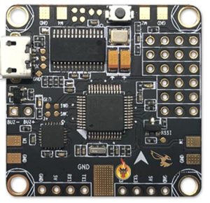

![Betaflight F3](https://dronemodelismo.com.br/wp-content/uploads/2018/02/mini-quad-fc-flight-controller-betaflight-f3-fpvmodel-300x290.jpg)
Betaflight F3

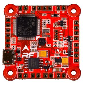

![Revolt F4 V2](https://dronemodelismo.com.br/wp-content/uploads/2018/02/RF-6810-300x297.jpg)
Revolt F4 V2

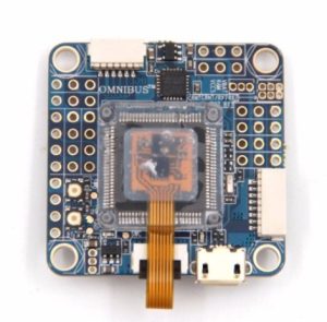

![Omnibus F7 V2](https://dronemodelismo.com.br/wp-content/uploads/2018/02/Omnibus-F7-V2-300x295.jpg)
Omnibus F7 V2
